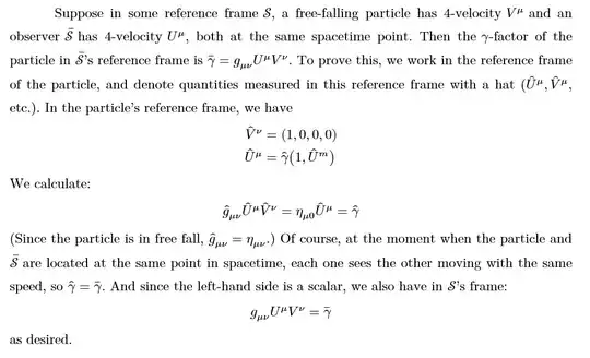

I think I've got a proof, see the screen shot below.
