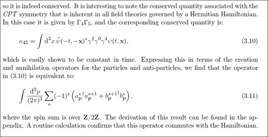

Specificaly, for the Dirac Equation and CPT symmetry the following conservation law is derived (ibid.):
