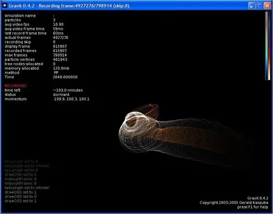

There are solutions stables with 3 body as we can see in this image.
Your question with two bodys in perpendicular orbits, I think that in general the orbits will tend to become planar. I didnt tested yet about the stability but I think that for aproximate radius they will be unstable.

I've done some simulations available here where a xls can be downloaded. example image
