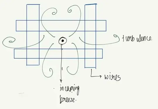

Imagine each wire as a cylinder that is applying drag on the incoming air. This drag creates a turbulent wake surrounding the wire. The eddies created in this turbulence are eating up the breeze's energy via frictional dissipation.
A schematic of the view from inside the room:
