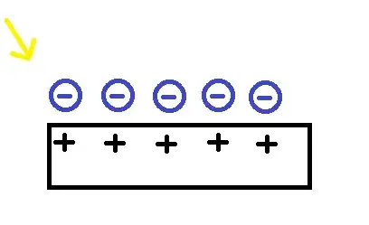

Only in the region extremely close to the metal. To begin, consider the situation with just the metal in water under light: electrons are liberated from the metal with a certain energy spectrum determined by the spectrum of incident light and the metal's work function. After these electrons are liberated, the metal has a net positive charge, and electrons are attracted back to the metal. An equilibrium is then reached between electrons leaving the metal and being drawn back to it. This is not really different to a sheet of metal electrically isolated in vacuum being irradiated. To put it in a schematic (yellow arrow represents light, black rectangle is the metal, circled negative signs are solvated electrons, plus signs are net positive charges left by ejected electrons):
Photoelectric effect steady state schematic
However, the lifetimes and mean free paths of solvated electrons in water are both extremely short (fractions of a nanosecond and nanometres), so this only affects the region of water extremely close to the metal. The bulk of the water effectively does not know that this is happening. If an electric field is applied through the water by a battery it will almost instantaneously distort this steady-state electron distribution very slightly, pushing the electrons closer to the positive terminal, but the conductivity of the water will not change from the very low value provided by $\text{H}_3\text{O}^+$ and $\text{OH}^-$ ions from self-ionisation.
