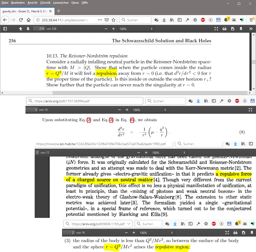

Charged black holes are described by the Reissner Nordström metric and including spin the Kerr Newman metric, the best you could get with that is a naked singularity when $\rm a$ or $\rm Q>M$.
The charge itself has its own gravitational field, but it's gravitationally repulsive, so that doesn't really help for creating a black hole out of it since for that the attraction must dominate, not the other way around.
