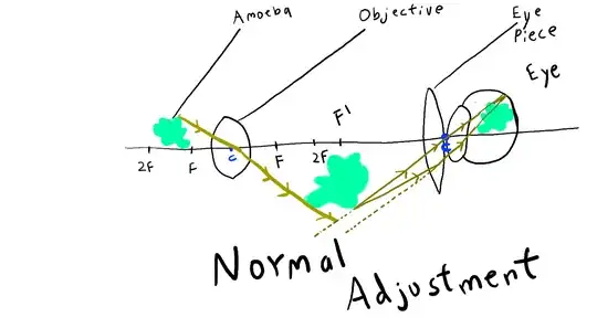

This is a a compound microscope viewing an amoeba the the normal adjustment. The objective lens has a smaller focal length than the eyepeice. enter image description here
A far off object(like moon) would be focused at the focus of the objective lens which after refraction of the eye piece would be such that only a dark image or blurry image would be seen by the eye because the final image would be on the other side to the eye as refracted by the eye-piece(rather than at the least distance or beyond). So our eye lens would not be able to focus that(atleast thats what I think).

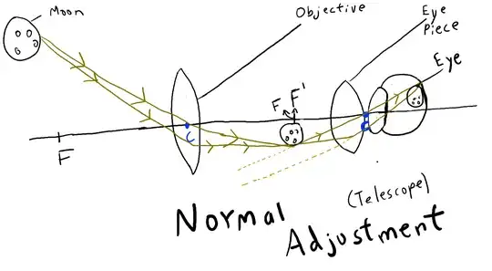

That problem is solved by an objective lens of larger focal length(used in telescopes) because then for a far off object, the object would still be focused at the focus of the objective lens but(for normal adjustment) that would also be the focus of the eye piece. So the image would be at infinity and enlarged like this. enter image description here

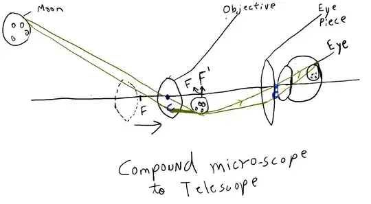

But cant we just bring the objective lens of compound microscope closer like this? [enter image description here
So in short my question is, if we move the objective lens of a compound microscope closer to the eye piece, would it behave like telescope? I believe yes but its magnification would be lesser than the telescope because the more the focal length of the objective, the more the magnification in a telescope(as per formula) but would a compound microscope behave as a telescope with lesser magnification in this case?

So you are better off looking the 'wrong' way through some microscopes and there may be a problem with the limited field of view.

This isn't an answer to your question. I would like to address a misconception in your diagrams. You show rays as bent when they pass through the image of an amoeba. The image is an empty region that light rays pass through. The rays should be straight.

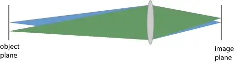

Object and image plane of a lens
The lens redirects the rays into new directions in a remarkable way. All the rays from the blue point are sent in directions that cross. Rays from the green point also cross at a nearby point point. People often just accept the diagram without realizing what a remarkable thing that is.
The image plane is just the place where all these focal points are. Light keeps going. The rays spread out again.
Unless you put something at the focal plane. Suppose the lens is the lens of your eye, and your retina is at the focal plane. Then one receptor in your retina is lit up only by light from the blue point. A nearby receptor is lit up only by light from the green point. That is how you see the amoeba.
Now suppose the lens is a biconvex lens, and you stand behind the image plane in the path of the spreading rays. The light that reaches your eye is very much like light that would reach your eye when you look directly at the amoeba. There is a blue point from which light spreads out, and a similar nearby green point. The lens in your eye focuses light from the image plane in the same way as for light from the object plane.
