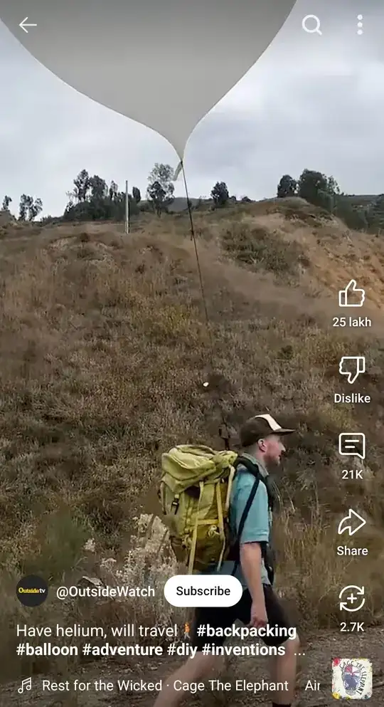

I recently saw a video where a man was walking with a heavy backpack tied to a large helium balloon. The balloon made the backpack feel much lighter and helped him walk more easily.
It got me wondering - how is the principle of conservation of energy applying here?
Imagine the balloon is perfect and doesn’t lose any helium, and the person walks a 100kms distance with it. The helium buoyancy reduces the 10kg backpack to just 1kg. Now, if the man walked the same distance without the balloon, he'd have to spend far more energy. How is the ballon able to provide the seemingly free energy?
I get that the balloon provides buoyancy, like floating in water, but I still can’t fully wrap my head around how the energy savings is achieved in this scenario and where is it coming from?
