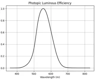

Photometric Units
However, this problem involves the visual perception of light. An alternative system of units has been developed which rescale the above quantities by the photopic luminous efficiency function which captures the sensitivity of the human eye under well-lit conditions to different wavelengths. The luminous efficiency function will be specified by the dimensionless $\bar{Y}(\lambda)$.
We can then define the spectral luminous as $$ S_L(\lambda) = K\bar{Y}(\lambda)S_R(\lambda) $$ where $K$ is a constant having the value \begin{align*} K = 683.002 \frac{\text{cd}}{W/sr} \end{align*} This constant is related to the SI definition of the candela. We see that the spectral luminance has units of cd/$\text{m}^2/\text{m}$ The luminous efficiency function $\bar{Y}(\lambda)$ can be found here and looks like
Photopic Luminous Efficiency
So we see that if we have the same radiant intensity at 550 nm and 650 nm, the radiant intensity at 550 nm will appear much brighter.
If we integrate the spectral luminance over all wavelengths we get the object's luminance with units of cd/$\text{m}^2$. If we integrate of the surface of the object we get the object's luminous intensity with units of cd. If we integrate over solid angles we get the object's luminous flux with units of $\text{cd}\cdot \text{sr} = lm$, lumens. If we integrate over time we get the luminous energy emitted with units of $lm\cdot s$. We can summarize the photometric counterparts to the radiometric units.

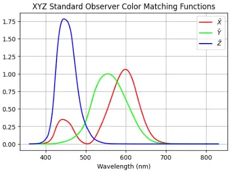

XYZ Color Space
The next part of the answer involves representing $S(\lambda)$ in different color spaces. The idea of color spaces is motivated by the observation that we can mix different combinations of colors but have the same perceptual experience of color and brightness. The phenomenon that different spectra can result in the same perceptual experience is called metamerism. The question is if we can apply some transformation to $S(\lambda)$ such that if two objects have the same transformed values then humans will have the same perceptual experience when observing the two spectra.
This question was studied in the early 20th century and resulted in the introduction of the 1931 CIE XYZ color space. We apply the following transformation to the spectrum $S(\lambda)$ to realize its representation in the XYZ color space: \begin{align*} X =& \int S(\lambda) \bar{X}(\lambda)d\lambda\\ Y =& \int S(\lambda) \bar{Y}(\lambda)d\lambda\\ Z =& \int S(\lambda) \bar{Z}(\lambda)d\lambda \end{align*} where the functions $\bar{X}$, $\bar{Y}$ and $\bar{Z}$ are the dimensionless CIE XYZ standard observe color matching functions which can be downloaded here and look like
XYZ Standard Observer Color Matching Functions
These color functions were experimentally determined using human subjects and color matching apparatus. The color matching apparatus allows researchers to understand and quantify how light with different spectra could result in the same perceptual experience for the human subjects.
Note the units of $X$, $Y$ and $Z$. If $S(\lambda)$ is the spectral radiance then $X$, $Y$, and $Z$ will all have units of radiance. It is very important to note that the $\bar{Y}$ function was chosen to exactly match the photopic luminous efficiency function. This means that $KY$ is equal to the luminance of the light source.
