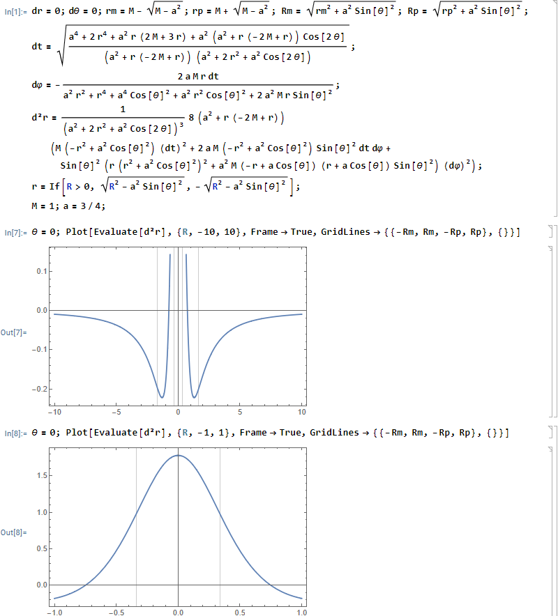

The curve of the $\rm d^2r/d\tau^2$ is symmetric in positive and negative $\rm r$ (at least in the polar slice, but farther away also at every angle), so if the $\rm d^2r/d\tau^2$ is negative at $\rm r>x$ then it is also negative at $\rm r<-x$.
A negative $\rm d^2r/d\tau^2$ at positive $\rm r$ means acceleration toward the black hole, while at negative $\rm r$ it means acceleration away from the black hole, so at negative $\rm r$ the black hole is mostly repulsive while at positive $\rm r$ it is mostly attractive.
Inside the Cauchy horizon the gravity can be repulsive even at positive $\rm r$ though, and in the negative region where no horizons exist it can also be attractive at comparable distances, so close above or below the ring you would always be accelerated in the positive $\rm r$ direction. Farther away it is the other way around.
For a detailed explanation see Madore, for the equations of motion in various coordinates see here.
