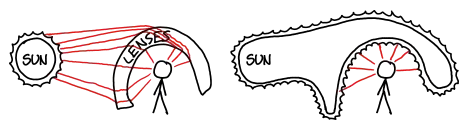

The optical system would be irreversible
If you want to focus all the Sun’s energy to a point, you will have a lens looking like this,
An irreversible optical system
which is not reversible and thus not possible to construct. Light from both B and A will go to C, heating it up beyond the temperature of the Sun. Yay! But optical systems should be reversible, i.e. if light goes from C through the lens it should end up where it was emitted. Unfortunately, if the lens focuses all the light onto a point, how will the light emitted at C know whether to go to A or B?
This implies that the optical system cannot exist. Optical systems focus things onto areas, not points. As such, you will find difficulty with…

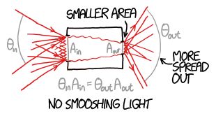

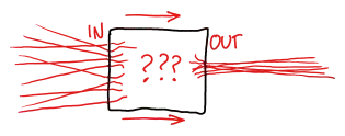

Conservation of étendue
There is such thing as conservation of étendue, which means that for light coming into an optic spread by angle $\theta_i$ on an area $A_i$ and emitted with angle $\theta_o$ and area $A_o$, you have $\theta_iA_i=\theta_oA_o$. Munroe explains it graphically in that What If question:
Magical light smoosher?
Nope, you can’t do this.
No, light cannot be smooshed.

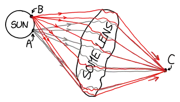

The best you can do is equivalent to being inside the Sun, which won’t make you hotter than the Sun
The absolute best an optical system can do is make all lines of sight end at the light source, like so:
Surrounding oneself with the sun is the best you can do.
And, of course, if you’re just surrounding yourself with the Sun, you cannot get hotter than your surroundings without violating thermodynamics, and as such you will quickly reach the temperature of your surroundings, i.e. the temperature of the Sun and no hotter.
