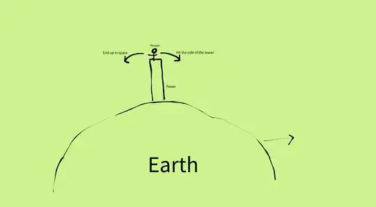

Now let's take an example of a person jumping from a tower. While the person is standing on the tower he is also in an non-inertial frame of reference like the person sitting in the car in the above example, similarly when the person jumps, his state is similar to the ball let go inside the car. My question is, unlike the ball that hits the back of the car, the person will always fall towards the earth. Why doesn't one of following happen ->
  1. The person hitting the side of the tower.
  2. The earth moving away from the person and him ending up in space. This is the diagram that illustrates a person ending up in one of the two situations mentioned above depending on the direction he jumps
Because the person has the same velocity as that of the earth in that direction for let's say the earth has an angular velocity of $10$ rad and that man doesn't have that then he should have been yeeted out in space because the ground has the same velocity as earth but he doesn't that's why the man will fall down straight because he already has speed in that direction and he is part of Earth's system
