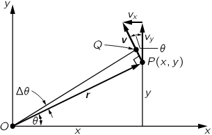

The above image shows the displacement of a particle in the $xy-$plane when it rotates about the origin $O$ from $P$ to $Q$. The image comes from https://www.feynmanlectures.caltech.edu/I_18.html.
From the picture, one can deduce that in a small time interval $\Delta t$, the displacement $PQ$ is: \begin{equation} r\Delta\theta = -\Delta x\sin{\theta} + \Delta y \cos{\theta} \end{equation} where $x$ and $y$ are respectively the $x-$ and $y-$positions of the particle, $r = \sqrt{x^2 + y^2}$ is the distance of the particle from the origin and $\theta$ is the angle from the positive $x-$axis to the line $OP$. If there is a '$\Delta$' in front of a quantity, that means a small(infinitesimal) change in that quantity. Divide both sides by $\Delta t$ and rearrange gives: \begin{equation} \frac{\Delta\theta}{\Delta t} = -\frac{\Delta x}{\Delta t} \frac{\sin{\theta}}{r} + \frac{\Delta y}{\Delta t} \frac{\cos{\theta}}{r} \end{equation} Because $\sin{\theta} = y/r$ and $\cos{\theta} = x/r$ and $r = \sqrt{x^2 + y^2}$: \begin{equation} \frac{\Delta\theta}{\Delta t} = -\frac{\Delta x}{\Delta t} \frac{y}{x^2 + y^2} + \frac{\Delta y}{\Delta t} \frac{x}{x^2 + y^2} \end{equation} In the limit as $\Delta t \to 0$, the right-hand side of the above equation gives the angular velocity in the $xy-$plane. Denote this quantity as $\omega_{xy}$ and note that $\lim_{\Delta t \to 0} \frac{\Delta x}{\Delta t} = \frac{dx}{dt} = v_x$, which is the velocity of the particle in $x-$direction, and $\lim_{\Delta t \to 0} \frac{\Delta y}{\Delta t} = \frac{dy}{dt} = v_y$, which is the velocity of the particle in $y-$direction: \begin{equation} \omega_{xy} = -v_x \frac{y}{x^2 + y^2} + v_y \frac{x}{x^2 + y^2} \end{equation} Similarly, the angular velocity in the $yz-$plane, $\omega_{yz}$, and the angular velocity in the $zx-$plane, $\omega_{zx}$, are: \begin{equation} \omega_{yz} = -v_y \frac{z}{y^2 + z^2} + v_z \frac{y}{y^2 + z^2}\\ \omega_{zx} = -v_z \frac{x}{z^2 + x^2} + v_x \frac{z}{z^2 + x^2} \end{equation}
