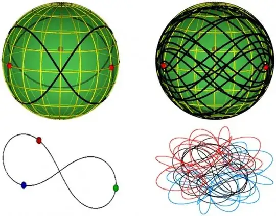

I am particularly impressed by how elaborate the solutions are, and I'm struck by the tantalizing hint of an infinity of other distinct orbits given by the analogy with a free group. The solutions can be viewed in the Three-Body Galery, which has animations of the new orbits in real space and in something called the 'shape sphere', which is described in the paper.
I was aware already of the figure-of-eight solution, which is described nicely in
