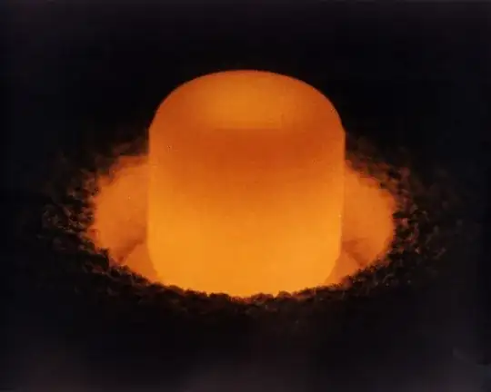

To be specific, let's assume we're using plutonium-238, which has a half-life of ~87.7 years. Plutonium-238 oxide pellet
Plutonium-238 oxide pellet glowing from its decay heat
It primarily decays by alpha emission, but there's a probability of ~$1.9×10^{-7}$% that a decay instead results in spontaneous fission, releasing neutrons and hazardous daughter isotopes. Pu-238 also emits some X-rays under 20 keV, and some gamma rays at 0.0436, 0.0996, and 0.152 MeV.
The density of plutonium-238 at room temperature is about 19.8 g/cm³. It generates about 0.57 watts per gram, or 11.3 watts per cm³, so you need a few cubic centimetres to keep your coffee hot, and that's not counting the shielding.

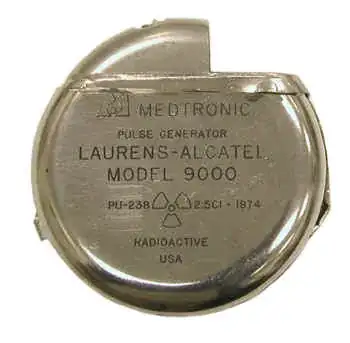

Despite all of these issues, Pu-238 was used in heart pacemakers half a century ago. From The Oak Ridge Associated Universities (ORAU) Museum of Radiation and Radioactivity:
Plutonium Powered Pacemaker (1974) Plutonium pacemaker
Pacemakers are used to stimulate a regular heartbeat when the body's natural electrical pacing system is irregular or not transmitting properly
At present (2003), there are between 50 and 100 people in the U.S. who have nuclear powered pacemakers [...] containing 2 to 4 curies of plutonium-238.
The unit's electronics are embedded in epoxy. The hard titanium case is designed to withstand any credible event including gunshots and cremation.
Dose rates at the surface of the pacemaker are approximately 5 to 15 mrem per hour from the emitted gamma rays and neutrons. The whole-body exposure is estimated to be approximately 0.1 rem per year to the patient and approximately 7.5 mrem per year to the patient's spouse.
Size: ca. 2.75" in diameter.
