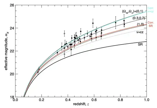

The errors become clear after a quick calculation: if we input $z = 1$ and $H = 70km/s/Mpc$ for instance, we get $m_B = 24.33$ for the SR interpretation and 25.44 for the $v = cz$ interpretation rather than $m_B = 22.83, 23.94$, respectively, as written in the paper. I've put the corrected magnitude-redshift curves into their original Figure 5.

In section 4.2, they write
[S]ince SR does not provide a technique for incorporating acceleration into our calculations for the expansion of the universe, the best we can do is assume that the recession velocity, and thus Hubble’s constant, are approximately the same at the time of emission as they are now.
This seems to contradict itself, since a constant recession velocity would be constant $\dot a$, not constant $H=\dot a/a$. If you suppose it's the former that they really meant, then $H = H_0/a = H_0(1{+}z)$. The extra factor of $1{+}z=2$ would shift the curve by $5\log_{10} 2 \approx 1.505$, and your values differ from theirs by $1.50$, so this is probably the culprit.
(Their calculation still doesn't make sense, because cosmological recession speed isn't the same as special-relativistic speed even in a special-relativistic model. They should have used the arctanh of the special-relativistic speed. See this answer.)
