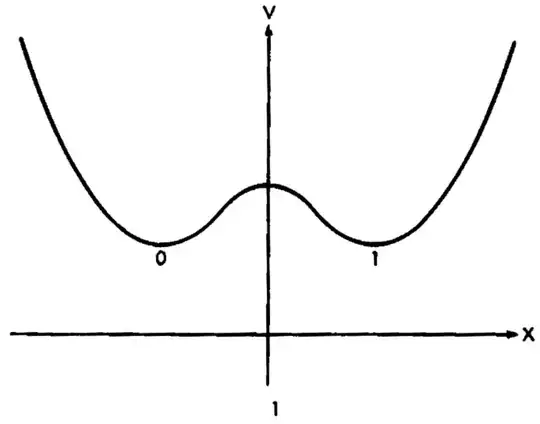

That is not what Landauer said in his almost 60 year old paper: "Irreversibility and heat generation in the computing process", R. Landauer, IBM Journal of Research and Development, Volume 5 Issue 3, July 1961, Pages 183-191:
"Our main argument will be a refinement of the following line of thought. A simple binary device consists of a particle in a bistable potential well shown in Fig. 1. Let us arbitrarily label the particle in the left-hand well as the ZERO state. When the particle is in the right-hand well, the device is in the ONE state. Now consider the operation RESTORE TO ONE, which leaves the particle in the ONE state, regardless of its initial location. If we are told that the particle is in the ONE state, then it is easy to leave it in the ONE state, without spending energy. If on the other hand we are told that the particle is in the ZERO state, we can apply a force to it, which will push it over the barrier, and then, when it has passed the maximum, we can apply a retarding force, so that when the particle arrives at ONE, it will have no excess kinetic energy, and we will not have expended any energy in the whole process, since we extracted energy from the particle in its downhill motion. Thus at first sight it seems possible to RESTORE TO ONE without any expenditure of energy. Note, however, that in order to avoid energy expenditure we have used two different routines, depending on the initial state of the device. This is not how a computer operates. In most instances a computer pushes information around in a manner that is independent of the exact data which are being handled, and is only a function of the physical circuit connections.
Can we then construct a single time-varying force, $F(t)$, which when applied to the conservative system of Fig. 1 will cause the particle to end up in the ONE state, if it was initially in either the ONE state or the ZERO state? Since the system is conservative, its whole history can be reversed in time, and we will still have a system satisfying the laws of motion. In the time-reversed system we then have the possibility that for a single initial condition (position in the ONE state, zero velocity) we can end up in at least two places: the ZERO state or the ONE state. This, however, is impossible. The laws of mechanics are completely deterministic and a trajectory is determined by an initial position and velocity. (An initially unstable position can, in a sense, constitute an exception. We can roll away from the unstable point in one of at least two directions. Our initial point ONE is, however, a point of stable equilibrium.) Reverting to the original direction of time development, we see then that it is not possible to invent a single $F(t)$ which causes the particle to arrive at ONE regardless of its initial state.
If, however, we permit the potential well to be lossy, this becomes easy. A very strong positive initial force applied slowly enough so that the damping prevents oscillations will push the particle to the right, past ONE, regardless of the particle's initial state. Then if the force is taken away slowly enough, so that the damping has a chance to prevent appreciable oscillations, the particle is bound to arrive at ONE.
Figure 1
Figure 1 Bistable potential well. $x$ is a generalized coordinate representing quantity which is switched.
Notice the similarity to a particle in a box.

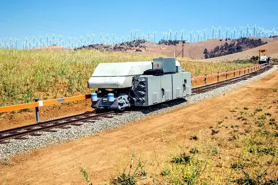

  • Regenerative Braking
    • Electric cars, trains, elevators, etc. have two states, changing to the other state recovers much of the energy. Depending on which state is loaded more energy could be generated than is expended, for example taking empty trains uphill to an ore mine.
    This is so efficient that custom trains have been manufactured solely to carry cement blocks uphill as a means to store power which is regeneratively recovered on the return trip.
    ARES Shuttle
