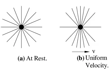

I understand that the field of a charge undergoes a relativistic length contraction when in motion. The images I see associated with this usually look like this:
Relativistic compression of field lines
As a layperson, I can't make any connection from this picture to a rotational field.
The more I look at it, the visual above is probably not even entirely relevant to the "line of electrons" scenario I described, since I think there would be a net cancellation of field lines except those perpendicular to the direction of travel. That realization gets me close to understanding how energy would exist in that orientation, but does not bridge the gap that connects the directionality of travel to the rotational direction of the field.

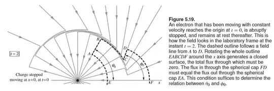

The closest thing I have seen that shows what I think I am looking for are figures like these:
Electron moving at constant velocity, then stopping
It's a little difficult to follow the story here, but it does otherwise clearly show how a rotational field can arise from the motion of a charge. My hope in looking at this is that my understanding is correct and the curved "shell" field lines are in fact the magnetic field.
Is that the case? If not, is there any better graphical representation that would show how electron motion gives rise to a rotational field?

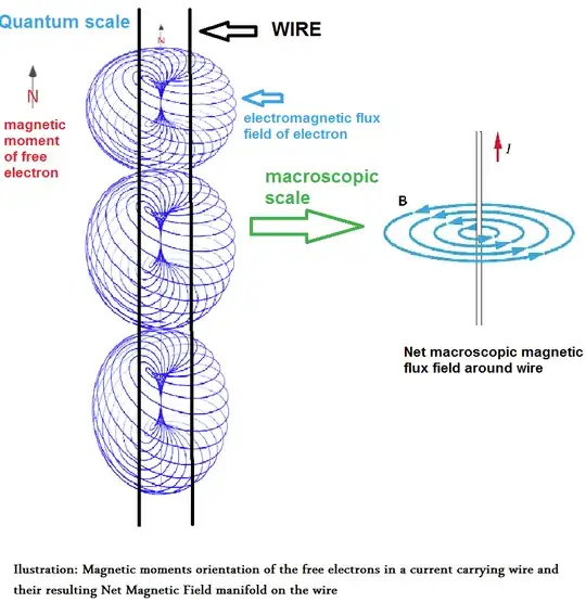

Interestingly, I think one of the images from the linked question is close to presenting a simple representation of what the Physics Detective calls "The Screw Nature of Electromagnetism":
Helical electric field lines
So while I don't have the ability to determine how "mainstream" the text response associated with that image is, the image itself seems helpful.

The answer is: No.
The curved shell in figure 2 is not relevant to the magnetic field (other than: Maxwell's equations--but that is true about any electric and magnetic field configurations).
Since you brought up the boosted electric field:
$$ \vec E'=\gamma(\vec E + \vec v \times \vec B)-(\gamma-1) (\vec E\cdot\hat v)\hat
v $$
which, with no magnetic field is:
$$ \vec E' = \gamma\vec E - (\gamma-1) (\vec E\cdot\hat v)\hat v $$
We can work that out. Note in any multidimensional situation:
  1. $\hat z$ is always longitudinal
  2. $\hat x$ is always the primary transverse direction
  3. $\hat y$ is always OOP (Out-of-Plane), which only matters with 3 body final states, or polarization DoF.
If you violate this: Insta Down Vote.
With that:
$$ \vec E = E\cos(\theta)\hat z + E\sin(\theta)\hat x $$
$$ \vec v = v\hat z $$
Then the boosted term (at origin overlap) are from
$$ \vec E \cdot \hat z = E\cos\theta $$
so
$$ \vec E' = E\cos(\theta)\hat z + \gamma\sin(\theta)\hat x $$
So the longitudinal (aka "parallel") field is unchanged, while the transverse field is boosted by $\gamma$. I would not call this "length contracted". Yes, the shape is, but it's actually getting stronger in the transverse direction.
The magnetic field transform is ($c=1$):
$$ \vec B'=\gamma(\vec B - \vec v \times \vec E)-(\gamma-1) (\vec B\cdot\hat v)\hat v $$
Since $\vec B=0$, that reduces to:
$$ \vec B' = -\gamma(\vec v \times \vec E)$$
In our case, that becomes:
$$ \vec{B}' = -\gamma v ({\hat{z}} \times \vec E) = \gamma v E\sin(\theta)\big(\sin(\phi)\hat x - \cos(\phi)\hat y\big) $$
where $\phi$ is the azimuthal angle.
That is clearly a magnetic field circulating around $\vec v$.
