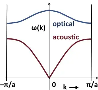

Let us first take a classical view of coupled oscillators - e.g., balls connected by springs or atom in a lattice (which, for small displacements, can be reduced to the balls coupled by springs.) Classical mechanics teaches us that we can find the normal oscillation modes of such a system, and represent any oscillation as a superposition of such normal modes. Any single mode then obeys a harmonic oscillator equation: $$ \ddot{Q}_k(t)+\omega_k^2Q_k(t)=0,\\ H_k=\frac{P_k^2}{2}+\frac{\omega_k^2Q_k^2}{2}. $$ See here for an example of a dispersion relation that we can get:

If we consider the same problem from the point of view of quantum mechanics, we expect that the excitations will be quantized. The quantization of Harmonic oscillator is a well-known problem - each mode will have discrete energies: $$ E_k=\hbar\omega_k\left(n_k+\frac{1}{2}\right), $$ where $n_k$ characterizes the level of excitation of modes. Note that, given the finite crystal size (i.e., the finite number of atoms - say $N$ atoms) we have finite number of modes, $k_1,...,k_N$, but the excitation numbers can be arbitrary.
