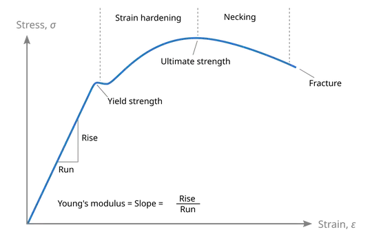

Like Ohm's law, Hookes law is not really a physics law, but an empirical conjecture that for most materials stress dependence on strain (i.e., the force dependence on displacement of a spring) has a linear part:
In other words, this "law" does not follow from the laws of quantum mechanics, but from the fact that a function allows linearization near zero displacement, i.e., its expansion in Taylor series has a non-zero second coefficient: $$ F(\Delta x)\approx F(0) + F'(0)\Delta x + ... $$
