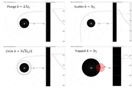

Here are some example trajectories produced using the GROrbits software. The black circle has a radius of $r_s$ and the values of $b$ are labelled. Note that even with $b$ specified as $3\sqrt{3}r_s/2$ to 5 decimal places the incoming light only executes a couple of circuits around the black hole before falling in.
The last diagram shows an example with the light emitted from within $r<3r_s/2$. If it has $b>3\sqrt{3}r_s/2$ then it falls back in again, if it has $b<3\sqrt{3}r_s/2$ it escapes.
