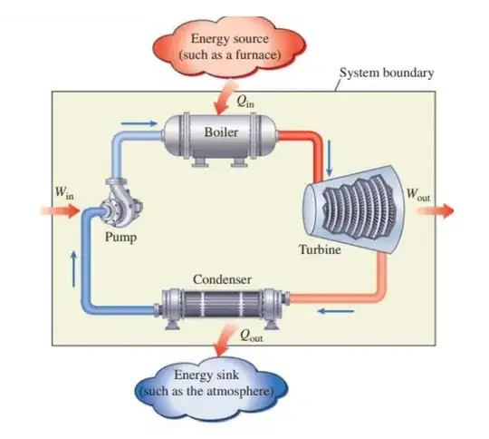

Suppose the working fluid is heated in a boiler by combustion of fuel outside the heat engine. If we assume that this a steady flow process with no change in time, neglect the kinetic and potential energies and heat losses from the boiler. The energy balance reduces to
$m^{.}h_{1}+Q^{.}_{in}=m^{.}h_{2} $
The working fluid expands then expands in a turbine thus generating work. If we assume that this a steady flow process, the system is adiabatic (heat transfer from turbines is negligible), and neglect kinetic and potential energy changes. The energy balance reduces to
$ m^{.}h_{2}=W^{.}_{out}+m^{.}h_{3} $
The working fluid leaving the turbine enters the condenser rejecting the remaining waste heat to a low-temperature sink. If we assume that this a steady flow process with no change in time, neglect the kinetic and potential energies and heat losses from the boiler. The energy balance reduces to
$ m^{.}h_{3}+Q^{.}_{out}=m^{.}h_{4} $
The working fluid is compressed or pumped to the boiler. The pump or compressor require power input from external source. If assume that this a steady flow process, adiabatic, and neglect the the kinetic and potential energies. The energy balance reduces to
$ m^{.}h_{4}+W^{.}_{in}=m^{.}h_{1} $
$ W^{.}_{net}=W^{.}_{out}-W^{.}_{in}=(m^{.}h_{2}-m^{.}h_{1})+(m^{.}h_{4}-m^{.}h_{3}) $
$ Q^{.}_{in}=m^{.}h_{2}-m^{.}h_{1} $
The performance of the heat engine is measured by $ \eta=\frac{(m^{.}h_{2}-m^{.}h_{1})+(m^{.}h_{4}-m^{.}h_{3})}{m^{.}h_{2}-m^{.}h_{1}} $
If we discard the condenser to save the waste heat and we send the working fluid directly to the pump or condenser. The energy balance for the compressor changes to
$ m^{.}h_{3}+W^{.}_{in}=m^{.}h_{1} $
$ W^{.}_{net}=W^{.}_{out}-W^{.}_{in}=(m^{.}h_{2}-m^{.}h_{1})+(m^{.}h_{3}-m^{.}h_{3})=(m^{.}h_{2}-m^{.}h_{1}) $
The efficiency equals 1 in this case. Why is the above scenario not feasible? The enthalpy of the working fluid that expands in a turbine to produce work decreases but which of the two terms of the combination (u+Pv) decreases (internal energy or flow energy) or do they both decrease?. I am asking this question to determine whether the temperature of the fluid decreases or stays the same. If the condenser is included, and we assume negligible pressure drop, enthalpy would decrease as the working fluid exchanges heat accompanied by a decrease in temperature. During compression, enthalpy increases but which of the two terms of the combination (u+Pv) increases (internal energy or flow energy) or do they both increase?
Should we reject heat because if we discard the condenser and directly compress the working fluid at a higher temperature we would need to intentionally cool it to bring it to the temperature of state 1 (the fluid entering the boiler)? Without cooling we can never attain state 1 we would obtain a state that's at a higher temperature
