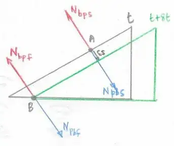

At time $t$ the block is at position $A$ on the plane and at some later time $t+\delta t$ the block is at position $B$ on the plane.
The red vectors shown the normal force on the block due to the plane at the s(tart) and f(inish) and the blue vectors shown the same for the normal force on the plane due to the block.
For both normal forces the displacement of the forces along their line of action is $\delta s$.
The work done by the normal force on the block is $N_{\rm bp}\times(-\delta s)$ and the work done by the normal force on the plane is $N_{\rm pb}\times(+\delta s)$.
As the normal forces have the same magnitude the net work done by the two normal forces is zero.

The interaction between the block and incline does no work overall. It does positive work on the incline and negative work on the block, but the combined work by the interaction has to be 0 since each force follows the same point of contact with the same magnitude but points in opposite directions.
Therefore, the only relevant net work on the system here is that done by gravity on the block, which is already accounted for in the total mechanical energy.
