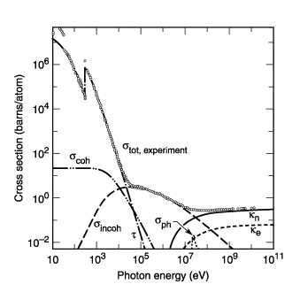

Figured it would be interesting to look at some X-ray scattering cross-sections for carbon. A wide variety of scattering processes are involved. I suggest the OP have a look at the different scattering mechanisms involved.
Fig. 3-1. "Total photon cross section $\sigma_{\hbox{tot}}$ in carbon, as a function of energy, showing the contributions of different processes: $\tau$, atomic photo-effect (electron ejection, photon absorption); ,$\sigma_{\hbox{coh}}$ coherent scat­tering (Rayleigh scattering—atom neither ionized nor excited); $\sigma_{\hbox{incho}}$ incoherent scattering (Compton scattering off an electron);$\kappa_n$ pair production, nuclear field;$\kappa_n$ pair production, electron field; $\sigma_{\hbox{ph}}$ photonuclear absorption (nuclear absorption, usually followed by emission of a neutron or other particle)" From this Lawrence Berkeley document.
