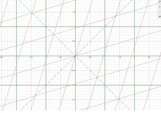

1D Flat Space-time without any gravitational effects would look like this diagram I made in Desmos, where the Green represents observer "Green" and the Red represents observer "Red". The Blue dashed lines represent light waves. (This Diagram is from my pet project - a fully functioning, mathematically correct description of Minkowsi Space-Time that I've made in Desmos with variables that can be altered representing relative velocity, acceleration, and other concepts)
1D Flat Space-time

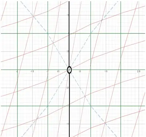

Option#1.) Here is a spatially 1D, 2D Minkowski space-time diagram, warped into the 3rd dimension to represent gravity. First, a crude diagram of what I mean by warped into the 3rd Dimension, and then a "top-down" view of the same diagram as before with the warping added. The black represents a body of mass. Note: Option#1 seems to imply speed of light is locally the same but a distant observer will see light as moving slower closer to mass - which I believe to be correct
Warped 2D Minkowski Space-time Option#1
Top-down view of Option #1

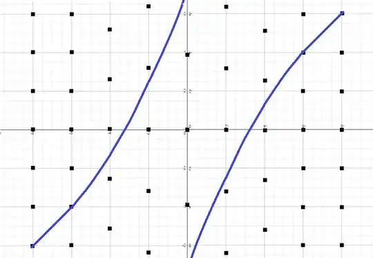

(Option#5) If time slows down near mass, and the time dimension is uniformly stretched vertically, while the horizontal space dimension remains normal (unstretched), can we construct an accurate non-grid model as I've attempted again using dot density as suggested, below?
If the distance lines are, for example, light-seconds - then the Squares can be representations of seconds from the perspective of an observer in various parts of the gravitational field. (The mass runs vertically along the center of the graph, passing through 0,0)
Attempt at constructing accurate representation of time-dilation for gravity field 1+1D

The horizontal lines are an arbitrary artifact - they convey the "present" lines of a stationary observer relative to the mass but they no longer are a fixed amount of time apart, because the length of time varies depending on where in the gravitational field we are.
Is this option correct, using a "gravity-like" concept for 1+1D according to your interpretation?
It's not clear that GR generalizes to 1+1D. In two dimensions the stress-energy tensor has more components than the curvature ($3>1$), so it's not obvious what the GR field equation should look like. That isn't the end of the world, because a lot of what people call "general relativity" is just calculating geodesics on a fixed spacetime manifold, and you could do that in 1+1D even if the shape of the spacetime isn't justified by a 1+1D theory of gravity. That aside:
In option 1 and option 2, it looks like you've just applied a distortion transformation to the $x$ or $y$ coordinate of your flat-spacetime diagram. If so, you're just plotting the same old flat spacetime in a funny way. Coordinate transformations don't change the intrinsic geometry.
Your other illustration, , doesn't seem to match what's meant by curvature in general relativity. If you draw a triangle on a piece of paper, its angles will add to 180°. If you bend the paper, the angles will still add to 180°. The paper is not truly curved unless the angles of at least some triangles on it add to something other than 180°. You can make a sheet of paper truly curved by dampening and then drying it. A truly curved sheet can't be flattened without tearing it.
A correct diagram of curved 1+1D spacetime probably can't look much like your diagram of flat 1+1D spacetime. In your flat-spacetime diagram, the solid lines are the 1+1D version of a Cartesian coordinate grid: evenly spaced parallel lines that intersect each other at right angles. In a general curved space, it isn't possible to draw such lines. Parallel lines may not exist (depending on how you define them), and in any case will not stay a constant distance apart when extended, and that's before requiring that they meet at right angles.
If you nevertheless draw a grid of some sort on the manifold, you then have the problem of how to plot it. If you use the grid coordinates for the plot, then the grid will look like a regular rectangular grid and won't visually indicate anything about the curvature.

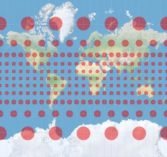

One solution would be to use Tissot indicatrix circles. Any 1+1D metric can be written at least locally in the form $ds^2 = f(t,x)^2 (dt^2-dx^2)$, which looks like Minkowski space except for the $f(t,x)$ scale factor. You could use the $(x,t)$ coordinates for plotting, drop the coordinate grid, keep the dotted diagonals representing lightlike geodesics, and add some circles whose radius is inversely proportional to $f$ (so that they all have the same physical area).
That's a mathematically accurate representation of the curved manifold. Whether it's understandable is up for debate. The Mercator projection with indicatrices looks like this:
By Tobias Jung, CC BY-SA 4.0, from the site linked earlier
That's a sphere, or a slightly oblate spheroid, but it's pretty hard to tell from the circles. Geodesics of the sphere are great circles, and look sinusoidal on the projection, but that's hard to tell too.
