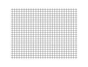

Sound propagates as a coherent mechanical wave. If $x$ is the direction of propagation of the wave, all the atoms/molecules with the same $x$ coordinate will oscillate in the same manner, transferring momentum to their neighbors. In the case of a solid medium, you can approximate the material as a collection of beads (the atoms/molecules) connected by springs (the atomic/molecular cohesion forces). The stiffer the springs, the faster the propagation of mechanical energy. This is why sounds propagates faster in steel than in water or air, where the cohesion forces are much weaker.
Longitudinal wave on a plane (From https://en.wikipedia.org/wiki/Speed_of_sound).
