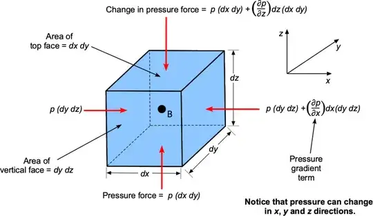

But what about something like picture related? So we have a differential volume cube: am I correct in my assessment that this dV is just a "change" from a point (0 volume) to a small amount of volume dV? And pressure is obviously supposed to be different on the other side, so that is represented with the change in pressure with partials? hydrostatic cube

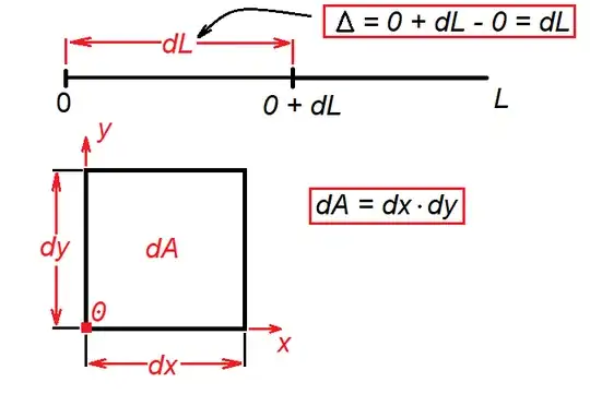

I understand intuitively what it is supposed to represent, but not sure how it mathematically makes sense. We take the limit of an area to go to 0, and then we gain insight in how pressure behaves at a single point (which is also counterintuitive but let's leave that for out). But mathematically, it means a "change in force for a change in area"? Or do we come back to the idea of an "infinitesimal amount of force per infinitesimal amount of area", where area is just a change from 0 to dA? I hope I am making sense here, because this should be a really simple case. But whenever I encounter a new differential expression, I am unsure how to understand it. I will attach one more picture for clarity of what I mean in my head when I say amount = change. infinitesimal length and area

Am I correct in my assessment that this $dV$ is just a "change" from a point (0 volume) to a small amount of volume $dV$ ?
No. $dV$ is simply the volume of the cube, which is assumed to be small - it does not represent a change from anything to anything. The sides of the cube have lengths $dx, dy, dz$ so we have $dV=(dx)(dy)(dz)$. The lengths $dx, dy, dz$ are assumed to be small enough so that the difference in pressure $p$ across, say the $x$ dimension of the cube can be approximated using the first partial derivative of $p$ only i.e. $p(x+dx) - p(x) \approx \left( \frac {\partial p}{\partial x} \right) dx$.

No. Again, $dF$ and $dA$ do not represent a change in force or area - they represent a small force or area. The basic idea is that if we just define pressure as force divided by area then the notion of pressure at a single point becomes difficult since we are dividing zero force by zero area, and the ratio is undefined. However, if we instead measure the force $\delta F$ across a small but finite area $\delta A$ then we can define the average pressure across $\delta A$ as
$\displaystyle p_{avg} = \frac {\delta F} {\delta A}$
and if we then allow $\delta A$ to approach zero then the pressure at a point can be defined as
$\displaystyle p = \lim_{\delta A \rightarrow 0} p_{avg} = \lim_{\delta A \rightarrow 0} \frac {\delta F} {\delta A} = \frac {dF}{dA}$
