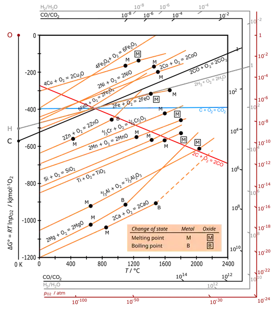

This is shown graphically by the Ellingham diagram:
Ellingham diagram
The way to use this diagram is to extend a line from the $\mathrm O$ point on the top left to the reaction of interest at the temperature of interest. The line then passes though the equilibrium partial pressure of oxygen. A higher partial pressure makes oxidation spontaneous; a lower partial pressure makes reduction spontaneous. Note, however, that the partial pressure you need to maintain to reverse rusting at room temperature is very small indeed, and that the diagram shows only equilibrium states, without information on how fast the process occurs.
