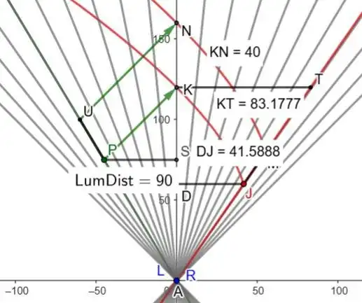

In the above diagram assume a supernova event occurs at J and the proper time interval of this event is 20 days. (D to S). Doppler time dilation predicts a time dilation factor of (z+1), so a supernova that has z=1 should be seen over a period of 40 days. This has been confirmed by actual observations. For a model to be valid it must be able to reproduce this time dilation factor. In the above diagram the SR model is on the left and the HF model is on the right. Both models reproduce the (z+1) Doppler time dilation factor. For the SR model, the coordinate time interval of the event is 25 days due to time dilation. It also occurs at a later cosmological coordinate time in the SR model, but due to SR time dilation the proper age works out the same as in the expanding model. There is exact agreement between the two models in this comparison and the signals arrive at the same time. Where they differ slightly is in the predicted distance from the observer of the supernova event.

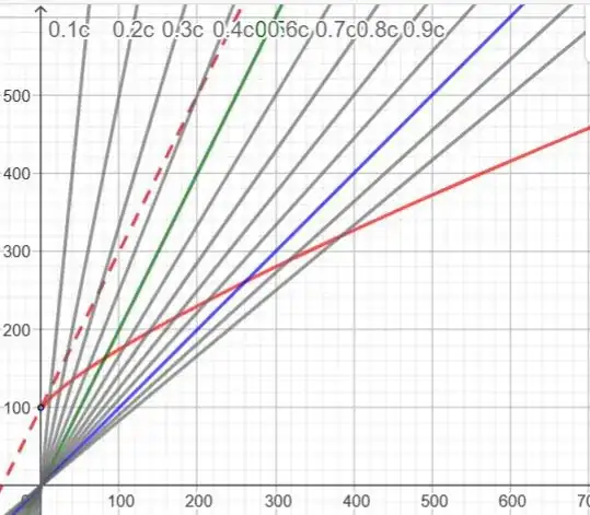

In the above diagram the dashed line represents a projectile in the SR Ballistic model that is launched at 0.5c. In this model its motion is entirely due to its initial momentum. If there is a galaxy also moving at 0.5c away from us that is at rest with the bulk Hubble flow (blue worldline) and initially at 50 units distance, the projectile will never catch up with distant galaxy and in fact will remain at 50 units distance away from it for all time in the SR model. Previously I incorrectly stated the HF model predicts the projectile will follow the trajectory represented by the solid red curve, but this was based on the assumption that a projectile with mass would comply with the same equation of motion as a photon. The massive projectile would in fact follow the dashed straight path in both models. A consequence of this fact is that in both models any inertially moving massive object will asymptotically come to rest locally in the Hubble flow.
The reason a light particle behave differently to a massive particle is that it has to maintain a local peculiar velocity of c and loses energy by changing to a lower frequency or longer wavelength. The massive particle on the other hand loses energy by slowing down it peculiar velocity. Similar behaviour can be seen in the Schwarzschild metric. A projectile fired upwards slows down locally and eventually comes to a stop. A photon climbing out of the gravitational well always has a local velocity of c but loses energy by changing wavelength instead.
The x coordinate of a photon moving outwards in the same direction as the Hubble flow as a function of time in the expanding universe model is given by:
$x_{out} = \frac{c}{V_h} \ \ln\left(1+\frac{V_h t}{D_e}\right) (D_e+V_h t)$
where $V_h$ is now the local Hubble flow velocity of a target galaxy and $D_e$ represents the distance of the target galaxy at the time the photon left. The photon trajectory would be more like the solid red curve in the above graph.

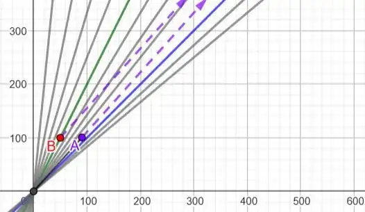

As mentioned at the start and as discussed above, inertial objects will move in exactly the same way in both models. Two objects that are initially at rest with respect to each other and initially comoving will maintain constant spatial separation as illustrated in the diagram below by the dashed purple trajectories. However it can be noted that over time the separation of the two objects appears to be getting smaller, because while they maintain constant separation relative to each other surrounding galaxies are moving apart relative to them.
