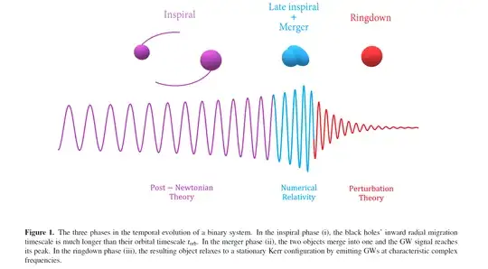

I was reading through the following paper GRMHD study of accreting massive black hole binaries in astrophysical environment: A review. Therein, we have the following image
It is not quite clear how long Post-Newtonian (PN) theory remains adequate and what distinguishes between an inspiral and a late inspiral. My questions are as follows:
  • How long does the inspiral phase last before it transitions into a late inspiral phase, rendering PN theory inadequate? In other words, how long do the early to mid-inspiral phases last, and how long does the late inspiral phase run?
  • Specifically, how long does a late inspiral phase last? In the book "Gravitational-Wave Astronomy: Exploring the Dark Side of the Universe," it is stated that
As an example, a $10M\odot$/$10^{6}M\odot$ system will spend the last few years of inspiral in a very tight orbit emitting $10^5$$10^6$ gravitational-wave cycles in the LISA band.
  • How do they determine that the late inspiral lasts this long, and how many gravitational wave cycles are emitted during this period?

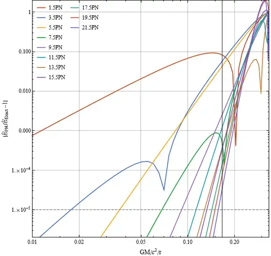

For $\nu=10^{-5}$, the relative error in the 5.5PN flux (chosen simply because I had the plot at hand) for quasicircular non-spinning binaries becomes larger than $10^{-5}$ at a separation of roughly $25 GM/c^2$. So, in this case the part of the inspiral between $25 GM/c^2$ and the last stable orbit ($6 GM/c^2$) can be considered "late inspiral". Since the shrinkage of the orbit is $O(\nu)$ per orbital cycles, this means that the binary $\nu=10^{-5}$ completes $O(10/\nu) \approx 10^6$ orbital cycles in the "late inspiral". These are very rough "back of the envelope" estimates. They can be made more precise by looking at numerical simulations of such inspirals, e.g. using the publicly available fast EMRI waveforms package, which uses interpolate numerical data obtained in the small mass-ratio limit.
Edit: Below is a plot showing the relative difference between the linear in $\nu$ part of the the energy flux to its $n$PN approximation as a function of the "compactness" ($GM/(c^2r)$) of the binary, using PN approximations available from the Black Hole Perturbation toolkit, and numerical data I generated myself. PN Flux residuals
