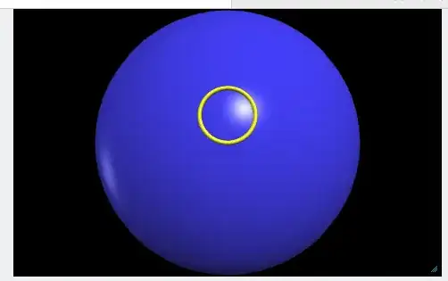

I'm trying to model a halo orbit at low altitude (10m from surface). The satellite is using propulsion to trace the circular halo path. It looks like this "from the top" (the blue ball is Earth and the yellow circle is the path traced by the satellite as it goes around the halo orbit):
low altitude halo orbit

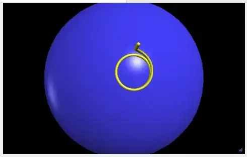

The simulation works, but given only the initial parameters, the orbit eventually becomes unstable and diverges
If the initial speed is too fast, the satellite will "shoot out" away from the planet (like in the picture below)
divergent halo orbit

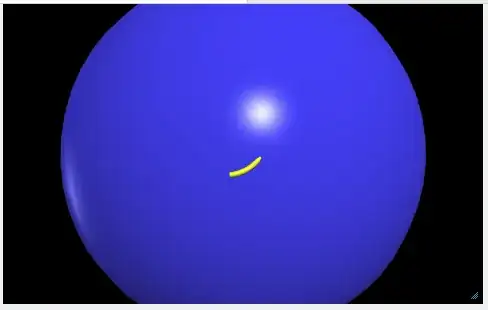

If the initial speed is too slow, the satellite will "fall to Earth" (the bodies are not solid in the simulation, so it goes through the planet to the other side)
decayed halo orbit
