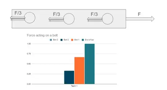

Simply schematics of what i think of.I have a question about the distribution of forces on bolts in mechanical connections. Suppose we have a flat bar bolted to a flat surface with three bolts along the longer edge. An equally distributed force perpendicular to the plane acts on the flat bar, trying to stretch it along the shorter edge.
Theoretically, this force should be evenly distributed among the three bolts, which means that each bolt carries F/3 of the total force. Why is this the case?
It's funny, because for a long time I didn't even question it, but recently someone asked me if we should change the design because the front bolt in a similar case transmits too much force. I couldn't find a good answer to this question
Some additional questions that stuck in my mind.
  1. Why do we assume that the force is distributed evenly across all bolts? What are the basic assumptions and principles that lead to this conclusion?
  2. In reality, is the force distribution exactly uniform? What factors can influence one of the bolts to carry most of the load?
  3. How can the proportion of force distribution on the bolts be changed? What design or material changes can affect a more or less uniform distribution of forces?
