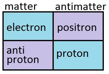

Yes. It's a matter of convention. Not a matter of particle properties. Think of a 2 x 2 table and list the properties of the electron, the positron, the antiproton, and the proton.

As regards the thrust of your question, see this article about positronium which says "to a first approximation it can be regarded as a sort of light hydrogen atom". Positronium is a short-lived exotic atom, comprised of an electron and a positron. We call the electron matter, and we call the positron antimatter. And positronium is like light hydrogen. So why do we call hydrogen matter? Throw away that convention and you could justifiably say the proton is the antimatter and the antiproton is the matter, and then say hydrogen is an exotic atom too. Especially since baryon asymmetry is counterbalanced by lepton asymmetry. I rather think it's something like a game of mixed doubles in tennis. One side was always going to win, and did win. But then we called the winning team the matter. And now we wonder why the ladies lost, when actually, they didn't:
