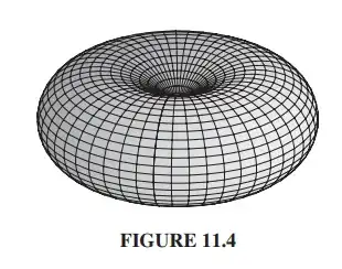

The textbook Griffiths provides a few concrete examples. The author starts with a point charge that oscillates up and down, and has a dipole moment $p = p_0 \cos(\omega t)$. He then approximates and solves for the E and B fields far away, and ignores the static fields:
If we then solve for the Poynting vector (a vector representing energy flow), and average over time enter image description here
This wave travels outward at speed c, with energy flow decreasing by $1/r^2$, and energy flow pointing radially outwards, exactly as you'd expect. Note that the waves are not spherically symmetric - the fields are smaller near the poles, and the energy flow depends on $\sin^2\theta$.
Now, technically this is not an exact solution to Maxwell's equations due to the approximations, but is very close far away. Luckily, Griffiths actually provides another example of spherical wave that is an exact solution (problem 9.35). It's quite similar - it has the same $\sin^2\theta$ term in Poynting vector.
Griffiths provides a general approximation for an arbitrary configuration (rotating dipoles, other arbitrary motion, etc.). He also shows that in general, any accelerating point charge produces spherical waves that travel outward at speed c.
