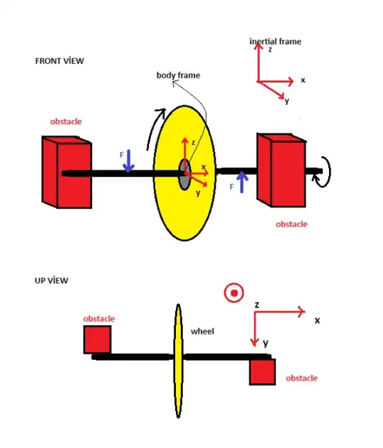

If we apply some torque to spinning wheel in a vacuumed space in body frame y axis, wheel try to precess due to gyroscopic effect but it will be prevented by obstacles as seen from picture,
  1. what will be reaction of the wheel?
  2. if the wheel turns in y axis then what will be total torque vector and how?

For the setup in the images you provided:
Without the obstacles the wheel would, after yielding to the torqe a little, start moving in precessing motion. That precessing motion gives rise to a tendency to rotate in the direction opposite to the exerted torque. That opposition acts against the tendency of the exerted torque.
For the setup in the images: the obstacles prevent onset of precessing motion. Without that precessing motion there is no opposition to the exerted torque. As a consequence the wheel will just keep yielding to that torque.
The motion of yielding to the torque causes the axle to push against the obstacles. Since this is an idealized thought demonstration we assume that that contact is frictionless. If the contact is frictionless then the push against the obstacles is without effect

The reaction torque of a gyroscopic flywheel is always such that it will align the rotation of the flywheel with the input torque rotation. This makes it easy to predict the behaviour of a gyroscope. Once the flywheel rotation is aligned with the input torque the precession stops.
If the wheel is not allowed to precess the wheel will no longer react and if the wheel axis is supported only at the right hand end the wheel will fall towards the ground like a normal weight. The behaviour of a flywheel depends on it being able to freely precess.
