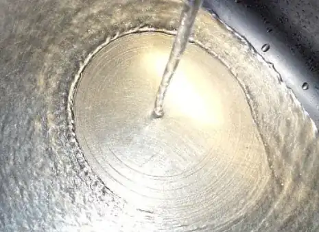

  • if you want to see shocks in shallow water you just need to turn on the tap and have a look at the water in the sink. If the jet is strong enough you could see stationary water jumps (the analogous of shock waves) in a system governed by the hyperbolic PDE system of shallow water equations.
