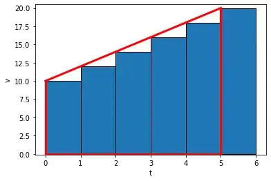

More importantly, with a large timestep getting things exactly right is harder. You made the simple mistake of including the endpoint in the sum. Let's see why that matters. Take a look at the graph below. Here you want to estimate the area under the red line and the area in blue is what you actually calculated. As you can see, the rectangle between $t=5$ and $t=6$ is a gross overestimation of the area, and it should not be included. If we exclude it, we get 70. This is already much closer!

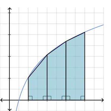

But we can do better. There is a more accurate way of numerical integration, called trapezoidal integration. Instead of summing little rectangles, we sum trapezoids. See the image below. Because we have a straight line, this will give the exact answer (can you reason why?). The area of a trapezoid is given by $\tfrac 1 2(a+b)w$ where $a$ is the left edge, $b$ is the right edge and $w$ is the width. The integration now looks as follows
\begin{align} \text{area }=&\,\tfrac 1 2(v_0+v_1)\Delta t+\tfrac 1 2(v_1+v_2)\Delta t+\tfrac 1 2(v_2+v_3)\Delta t\\ &+\tfrac 1 2(v_3+v_4)\Delta t+\tfrac 1 2(v_4+v_5)\Delta t\\ =&\,\Delta t(\tfrac 1 2 v_0+v_1+v_2+v_3+v_4+\tfrac 1 2 v_5) \end{align}
Plugging in your values (with $\Delta t=1$) gives \begin{align} \tfrac 1 2 \times 10+12+14+16+18+\tfrac 1 2 \times 20=75 \end{align}
So using trapezoidal integration, we arrive at the right answer. But note that this happened because we integrated a straight line. If we integrated a parabola or something more complicated, we would still be off. But by reducing the timestep you can get as close as you want.

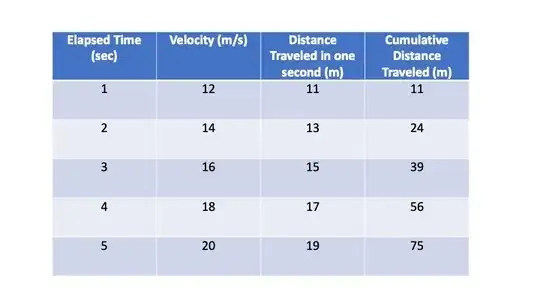

The times shown in the table are elapsed times. Then the table fills in as shown below.
Hope this helps.

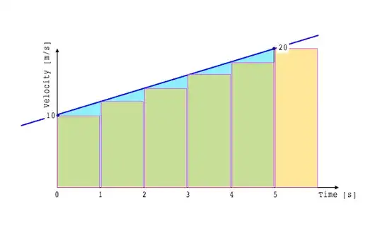

As @AccidentalTaylorExpandsion explained, you are looking for the blue area under the curve below
fig1
But by just adding the values, you got the total yellow area above. The two problems here, is that you are counting the last row for the total distance traveled. So your are overcounting for distance that would be traveled after 5 seconds.
Also and each arbitrary time step assumes constant velocity throughout the step, and as a result you are undercounting for the little blue triangles above each bar.
