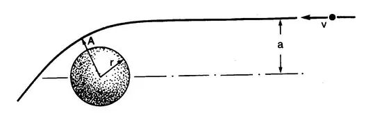

If you want an example of significance of torque, here's a question:
Find the distance of closest approach of a spaceship far away moving with initial speed v and at a perpendicular distance of "a" from the sun. Assume sun is stationary. enter image description here
Try the question by using only free body diagram (will require high level calculus) and also try by using the concept of torque(will take less than 2 minutes to solve)
I'll share the solution after you have tried your best :D
