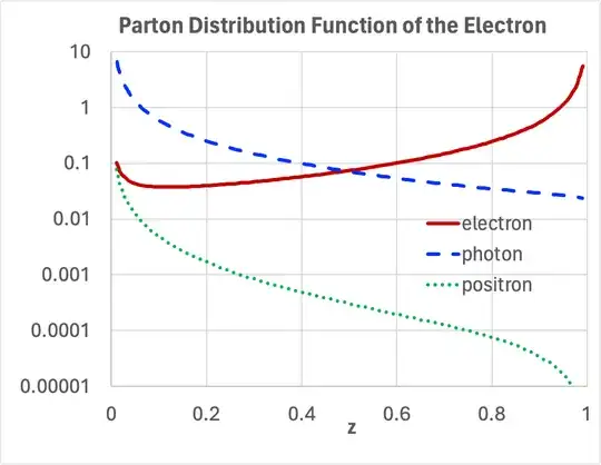

I am not aware of any attempt to precisely determine the electron-positron content of the proton, but the analogous electron-positron content of the electron is more tractable and has been calculated. If my quick and dirty numerical integrations of the PDFs in Figure 5 (below) of "The partonic structure of the electron at the next-to-leading logarithmic accuracy in QED" are correct, at an energy scale of $100$ GeV, photons carry a few percent of an electron's momentum and positrons carry about $0.02\%$.
Parton Distribution Function of the Electron
