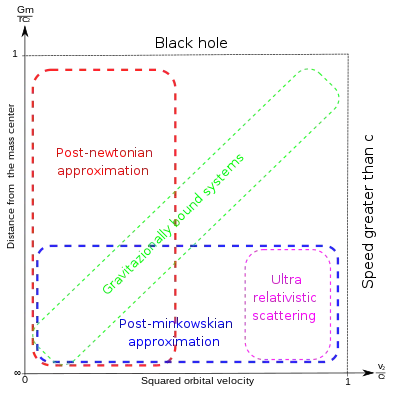

Gravity is a little more complicated. I posted it somewhere on this sight, from a paper, but the result is you can expand the Schwarzschild metric into a potential and factor out the newtonian part of each term and get something like:
$$ \Phi(r) = -\frac{GM}{r}\Big({\bf 1} + \alpha_2\big(\frac{r_S}r\big)^2 + \alpha_4\big(\frac{r_S}r\big)^4 + \cdots \Big) $$
where the $\alpha_i$ are "average" size, and the scale parameter, $r_S$, is the Schwarzschild radius.
When these are applied in the real world (aka: interplanetary spacecraft navigation), they're called parameterized post Newtonian formalism ( https://en.wikipedia.org/wiki/Parameterized_post-Newtonian_formalism) for massive bodies, and post-Minkowski expansion for high speeds (https://en.wikipedia.org/wiki/Post-Minkowskian_expansion) covering: enter image description here
