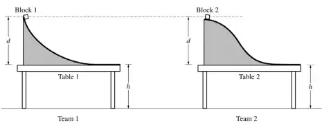

There are two blocks, each starting at the top of an incline. The particular inclines are depicted in the image below.
The height through which the blocks fall is the same, the table lengths are the same, and the height of the tables is the same. The question asks which block hits the floor first. One solution argues that the first block hits the ground first. This is because the the slope of that incline is steeper, so the block reaches the bottom of the incline faster.
I remain unconvinced by this argument. I am not sure how one can make an argument without doing a more detailed analysis on the inclines. The information is not provided to perform this analysis, so I assume it is not truly necessary.
The reason I am unconvinced by this answer is that, despite the slope of the first incline being steeper at the beginning, I feel this means the slope must be less steep near the end of the trajectory. I believe this because the entire vertical and horizontal distance traversed by the block is the same in both cases. If the slope is steeper at the beginning for the first block but steeper at the end for the second block, then how can we conclude anything?

By energy conservation (I assume that the slopes are frictionless and $U(y):= mgy$) $$U(y)+ \frac{m}{2} {\bf v}(y)^2 = U_0 = U(d+h)$$ That is $$\frac{m}{2} \left(\left(\frac{dy}{dt}\right)^2 + \left(\frac{dx}{dt}\right)^2\right)= U_0- U(y)\:.$$ Namely $$\frac{m}{2} \left(\left(\frac{dy}{dt}\right)^2 + \left(\frac{dx}{dy}\frac{dy}{dt}\right)^2\right)= U_0-U(y)\:.$$ Equivalently, $$dt = \frac{\sqrt{\frac{m}{2}} \sqrt{1+ \left( \left(\frac{dy}{dx}\right)^{-1}\right)^2}}{\sqrt{U_0-U(y)}} dy$$ As a consequence, the considered lapse of time amounts to $$T = \int_{d}^{h+d} \frac{\sqrt{\frac{m}{2}} \sqrt{1+ \left( \left(\frac{dy}{dx}\right)^{-1}\right)^2}}{\sqrt{U_0-U(y)}} dy \:.$$ The only difference in the integrands in the two cases is the derivave $\frac{dy}{dx}$. From the figure, it seems clear that $$\left|\frac{dy_1}{dx}\right| \geq \left|\frac{dy_2}{dx}\right|$$ and thus $$\frac{\sqrt{\frac{m}{2}} \sqrt{1+ \left( \left(\frac{dy_1}{dx}\right)^{-1}\right)^2}}{\sqrt{U_0-U(y)}} \leq \frac{\sqrt{\frac{m}{2}} \sqrt{1+ \left( \left(\frac{dy_2}{dx}\right)^{-1}\right)^2}}{\sqrt{U_0-U(y)}}$$ When integrating, we have $$T_1 \leq T_2$$
Looking at the pictures I would also claim that the first one is faster. My argument would be, that both curves seem to reach a similar point at about $\frac{2}{3}$ of the horizontal and about $\frac{7}{8}$ of the vertical distance to their starting point. Looking at the route prior to reaching that point we see that the left curve is significantly below the right curve at all points. That means that on the first $\frac{2}{3}$ of the horizontal the Block rolling down the left curve will be a lot faster then the block on the right curve, while the traveling distance up to that point seems similar. At that point both objects will already have reached around $\frac{7}{8}$ of their maximum kinetic energy, which means they reached even more then $\frac{7}{8}$ of their maximum speed. Therefore, what ever differences in steepens of the routes may be present to the right of that point will make a very small contribution to the overall travel times of the blocks compared to the differences picked up on the route prior to reaching that point.
Generally acceleration at the start of the curve will cause a larger contribution to the reduction of the travel time, then the same acceleration at a later part of the curve, because the block will travel a larger distance at the increased speed.

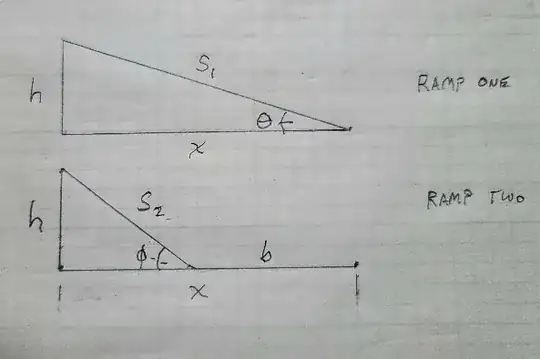

This problem can be simplified by comparing two ramps of different slopes.
At the bottom of both ramps, the object has the same speed. The object with the steeper slope, however, reaches that speed in a shorter time. It's important to note that the second ramp occupies a smaller area then ramp one in the rectangle formed by $xh$.
enter image description here From basic kinematics, the time needed to traverse the horizontal distance $x$ for the first ramp is:
$$t = \sqrt{\frac{s_1}{2g sin \theta}}$$
The time to travel the same horizontal distance $ x$ for the second ramp has two parts: The time to traverse the second ramp:
$$t_1 = \sqrt{\frac{s_2}{2g sin \phi}}$$
and the time to traverse the remaining horizontal distance b:
$$t_2 = \frac{b}{v_f}$$ where $v_f$ is the velocity at the end of the ramp. If $t' = t_1 + t_2$, then the ratio of the two times for each ramp is: $$\frac{ t'} t = \frac{(\sqrt{\frac{2 s_2}{gsin\phi}}+\frac{b}{v_f})}{\sqrt{\frac{2 s_1 }{gsin\theta } } }$$
This can be simplified since $s_1 = \frac{h}{sin\theta}$ and $s_2 = \frac{h}{sin\phi}$ and $$v_f = \sqrt{2s_1gsin\theta}$$
This leaves:
$$\frac{t'}{t } = \frac{ sin\theta}{sin\phi} +\frac{bsin\theta}{2h}$$ with $$b = x-hcot\phi$$
Since $tan\theta = \frac{h}{x}$ then,
$$\frac{t'}{t} = \frac{sin\theta}{sin\phi} + \frac{sin\theta(cot\theta - cot\phi)}{2}$$
The ratio of times are now expressed only as a function of the two angles or ramp slopes.
While it's not obvious, if $\phi > \theta$, then t > t' which supports the argument that the path with largest average slope will be the faster path. Also, the longer path may be the faster path. The path length of second ramp is longer than the path of the first ramp.

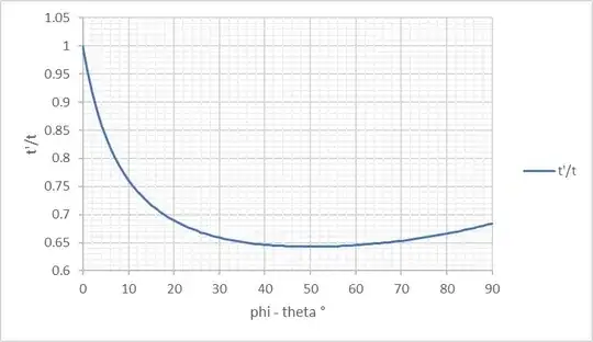

The graph has $\theta$ fixed at 10° while $\phi$ starts at 10° and increases. There are two competing effects wrt. ramp two:
  1. The increase in acceleration due to increasing slope.
  2. The increase in path length due to increasing slope.
These effects are minimized when $\phi - \theta = 45°$
Note that the ramp that occupies the smallest area over the distance x and a height of h will cover the distance x in the least time.

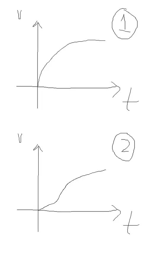

Here's another way to think about it (the other answers seem to use very complicated concepts on a relatively simple problem to me). Draw the velocity vs. time graphs for both situations. You should end up with something like this, and it should be intuitively obvious:
Where the top figure is for situation 1 and the bottom figure is for situation 2.
The distance travelled is the area under the curve, and block 1 obviously travels a larger distance than block 2, for the same amount of time. Therefore, unless you have reason to believe that the slope in situation 1 is longer than the slope in situation 2, block 1 should reach the bottom first.
