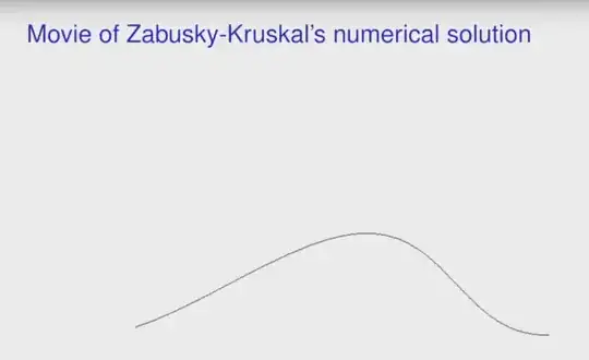

Here are a couple screenshots from Chuu-LianTerng: Solitons in Geometry, starting about 11 minutes in. This is a rather mathematical lecture on solitons with various examples. Initial state:

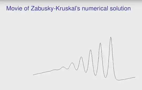

Later:
