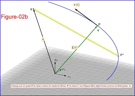

(1). In the general case of a charge in an arbitrary motion the electric field at a point changes at present time $\:t\:$ by a "signal" emitted from the retarded position of the charge at the retarded time $\:t_{ret}$. This "signal" propagates with velocity $\:c\:$ from the retarded position to the field point for a time period $\:\Delta t = t-t_{ret}$. In general the electric field is not directed radially with respect to the retarded position. See equations (01.1),(01.2) in my answer here : Electric field associated with moving charge. In these equations the electromagnetic field is expressed as function of the retarded position and time. enter image description here

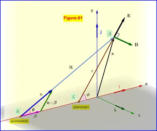

(2). In the special case of a charge moving with constant velocity the electric field is accidentally expressed as function of the present position and time and is directed radially with respect to the present position. See equation (04) and Figure-01 also in my answer here : Electric field associated with moving charge. This fact seemingly gives us the impression that the field changes instantaneously and simultaneously with the instantaneous motion of the charge, i.e. an infinite speed interaction.
