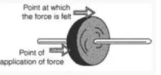

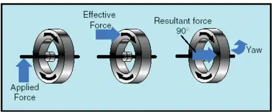

I am trying to simplify gyroscopic precession for PPL Helicopter students and in the process confused myself. Many texts define it as processing a force 90 degrees when the force is applied 'parallel to the axis of rotation' while others say 'perpendicular to the axis of rotation'. I even read text where they brought in a force applied 'perpendicular to the plane of rotation' (which I understand is the same as 'parallel to the axis of rotation').
Example 1: Gyroscopic precession. -- A characteristic of all rotating bodies. When a force is applied to a rotating body parallel to its axis of rotation, the rotating body will tilt in the direction of the applied force 90 degrees later in the plane of rotation. or When force is applied perpendicular (at 90 degrees) against any rotating object like our spinning bicycle wheel. (which I understand as being the same as parallel to the axis of rotation)
Example 2 When a torque is applied perpendicular to the axis of rotation... enter image description here
Or is the effective force always 90 degrees against the spinning wheel regardless of whether the force applied is 90 degrees to the axis or parallel to the axis?

You first have to express thing in terms of torque, otherwise there is no clear answer.
Precession occurs if a torque is applied perpendicular to the axis of rotation. Such a torque can be applied with a force, or a set of forces (often a pair of opposite forces is used). Those forces then should have at least a component perpendicular to the torque you want to create, the concept of torque requires that.
But together, this just means that the force you need must have a component that is perpendicular to a torque that is perpendicular to the rotation axis. That can be solved with forces parallel to this axis, but also with forces perpendicular to the axis. Using torque is the only way to see what is going on!

As pointed out in the answer by Jos Bergervoet, it is necessary to specify applied force in terms of torque.
About onset of gyroscopic precession:
I need to establish some basics first:
When a torque is applied to a spinning wheel the initial/momentary response is to yield to that torque (a little). It is the motion of yielding to the initial torque (a little) that induces the subsequent precessing motion.
Discussion of onset of gyroscopic precession, illustrated with diagrams, is in a 2012 answer by me to a question titled 'What determines the direction of precession of a gyroscope?'
In that discussion I capitalize on symmetry. The reasoning is simplified by a division in quadrants.
In that 2012 answer I use the case of a gimbal mounted gyro wheel with the spin axis parallel to the local horizontal.
So, in order to visualize the response of the rotating helicopter blades you remap the orientations of the explanation to that case.
