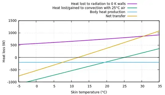

Regarding feeling the coldness: Sure, humans feel when their skin emits more IR radiation that is received. You can test this easily by opening a freezer and standing some ways away from it (avoiding the cold air itself).
For the follow up question, we can calculate it:
Assuming the person is naked, their outer surface is about 33°C = 306 K. If they are standing up, surface area is roughly 1.8 m². The total emitted black body radiation can be calculated as:
$$P_\text{net} = A \sigma \varepsilon \left( T^4 - T_0^4 \right)$$
Where $\sigma$ is the Stefan–Boltzmann constant and $\varepsilon$ is the emissivity, which is close to 1. With $T$ = 306K and $T_0$ = 0K, this gives 895 W. The human body internally produces about 200 W of heat in mild exercise or when shivering. This gives net transfer of 700 W.
The cooling effect of the emitted radiation is balanced by the heating effect of the air once skin temperature drops below 25°C. Based on a rough value of convection in otherwise still air of 20 W/m²K, the balance point is skin temperature of 12°C. This is too low for long term survival, so we can be sure that eventually the person will die. In the initial state the conduction to air would further cool the skin at 288 W, but skin temperature will quickly drop to near the air temperature.
Heat transfer by skin temperature graph
How fast will this happen? Based on thermal capacity of water and a body weight of 80 kg, with 700 W net heat emission, body temperature would drop by 8°C every hour. Hypothermia would begin in about 15 minutes and loss of consciousness in an hour. Human body's mechanisms to reduce blood flow to extremities will give a little more time by reducing internal heat conduction.
Compared to vacuum, cooling down would be slower because of less evaporation, but otherwise the situation is similar. Of course in vacuum you would suffocate long before freezing. Even a thin layer of clothing would greatly prolong the survival, and thick enough clothing would prevent freezing altogether.
