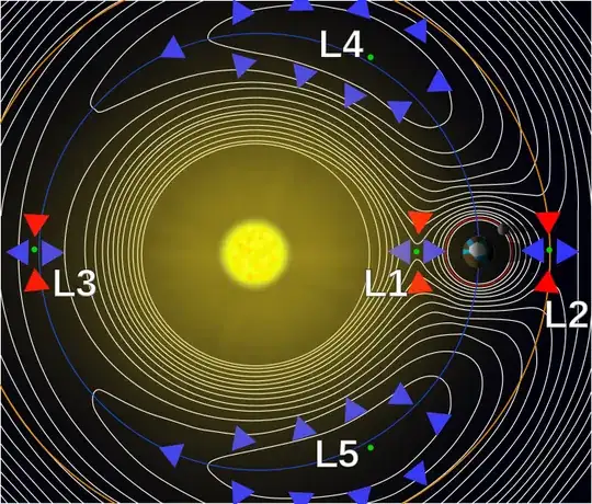

The moon will always "perturb" the orbit to some extent, but to "disrupt" an orbit is to kick the satellite out of orbit. And this will only happen if the orbit is very wide, approximately when it reaches the Lagrange point L1, at about 85% the Moon's distance! Here's a drawing clearly showing stable and disrupted orbits: (replace Sun-Earth system with the Earth-Moon)
https://en.wikipedia.org/wiki/File:Lagrange_points2.svg https://en.wikipedia.org/wiki/Lagrange_point#/media/File:Lagrange_points2.svg
The drawing also shows that things are much less favorable for orbits around the smaller mass, i.e. a satellite around the Moon instead of Earth. More precisely, the region around the Moon where those orbits would still be stable is the so-called Hill sphere: $$ R_H= (e-1) \ a \ \left(\frac{m_2}{m_1+m_2}\right)^{1/3} $$ but with masses $m_1$ and $m_2$ for the Earth-Moon system (and $e$ and $a$ the exentricity and semi-major axis) that gives almost the same result as just using the L1 position.
