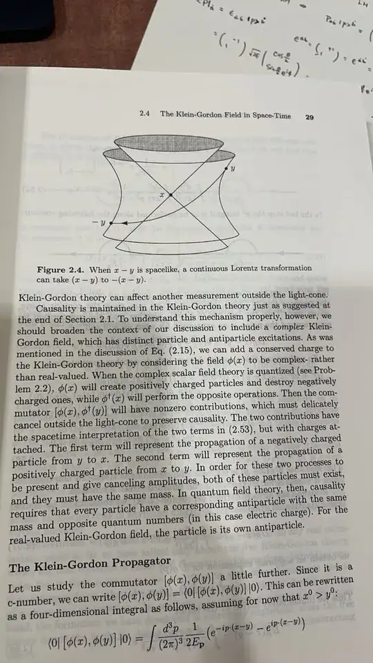

For the normal $3+1$ D case, since for any space-like separation $(x-y)$,
there is a Lorentz transform $\cal{L}$ continuous to the identity (i.e., ${\cal{L}}\in \mathrm{SO}^+(1,n)$), such that ${\cal{L}}(y-x) = (x-y)$,
it follows that $D(y-x)=D(x-y)$ and the commutator vanishes,
as illustrated by the $2+1$ D example in the following figure:
spacelike
The argument however cannot be made for the $1+1$ D case; is there some other way to show causality for this case?
