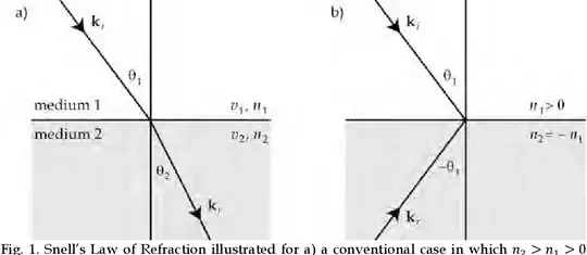

Recently I was asked in a test what would happen if the refractive index of a medium was negative. Is it possible really? The refractive index is the ratio of the speed of light in a vacuum and another medium. It can't be less than $1$ also the speed of light is the fastest in a vacuum. So how come it'll be negative? Does the light refuse to enter a medium?

A negative refractive index is a concept that arises in the field of metamaterials, which are artificial materials engineered to have properties not found in naturally occurring materials. This concept significantly alters our understanding of wave propagation, especially in terms of the direction of travel, the direction of information transfer, and the behavior of light. Here's a breakdown of what a negative refractive index means in these contexts:
Wave and Poynting Vector (Direction of Energy Flow):
In normal materials with a positive refractive index, the wave vector (which represents the direction of wave propagation) and the Poynting vector (which represents the direction of energy flow) are parallel to each other.
In materials with a negative refractive index, the wave vector and the Poynting vector are antiparallel. This means that although the wavefronts of light (or other electromagnetic waves) are moving in one direction, the energy carried by the wave is flowing in the opposite direction.
Wave Propagation (Direction of Travel, Direction of Information Transfer):
The unusual alignment of the wave vector and the Poynting vector in negative refractive index materials leads to some counterintuitive effects, such as reverse Cherenkov radiation and reversed Doppler effect. The direction of information transfer, typically aligned with the direction of energy flow (Poynting vector), is opposite to the direction in which the wavefronts seem to travel (wave vector). This can have implications for how signals and information are transmitted through such materials.
Speed of Light:
In any medium, the speed of light is affected by the medium's refractive index. In materials with a negative refractive index, light behaves in unconventional ways, but the principles of causality and relativity still apply.
The phase velocity (related to the wave vector) can be in the opposite direction to the group velocity (related to the energy and information transfer). However, it's important to note that the group velocity, which is typically associated with the actual transport of information, does not exceed the speed of light in a vacuum, thus adhering to the principles of special relativity.
These phenomena are at the frontier of optical and material science research, and they have potential applications in developing new technologies such as superlenses (which can achieve resolution beyond the diffraction limit of light) and cloaking devices. The field of metamaterials, which predominantly explores these unusual properties, is constantly evolving, leading to new theoretical and practical insights.
