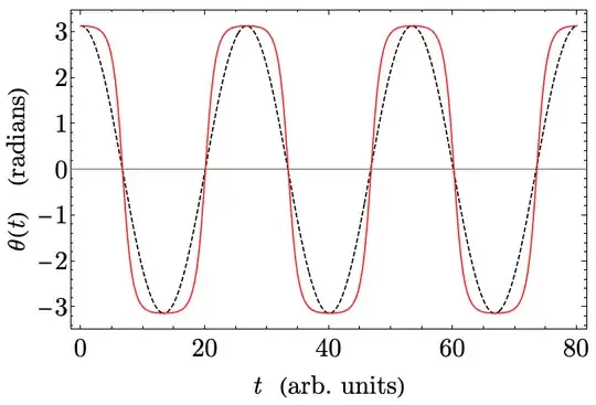

Here, we give a nice physical reason, in terms of forces and accelerations, for why and how a pendulum is different than a simple harmonic oscillator. The tldr is that the restoring force increases linearly with amplitude for a SHO, but for a pendulum, the force actually decreases down to zero once the amplitude gets large enough. This results in the pendulum spending much more time at the full amplitude positions than an oscillator when the amplitude is large enough.
We know that simple harmonic motion, described by the differential equation $\ddot{x} = -\omega^2 x$ is solved by sinusoidal functions, $x(t) = A\sin(\omega t+\varphi)$. Notably, at the turning points (positions where the oscillator is at its maximum displacement from equilibrium and hence instantaneously stopped), the force is the largest, meaning that the curvature of the function is maximal, and this is true no matter how large the amplitude is. This gives rise to a function that is more sharply curved at minima and maxima, and this graphical fact represents the fact that it doesn't take a long time for the oscillator to come to a stop, turn around, and move back in the other direction.
Now, imagine a pendulum with a thin, rigid rod in place of a string. The restoring force on the mass at the end of the rod is the component of the gravitational force pointed tangent to the circle in which the mass moves. This restoring force increases approximately linearly as the amplitude grows from zero. However, once the angle gets large enough, this force no longer grows linearly. In fact, the restoring force becomes a maximum when the rod is held horizontal to the ground, when the amplitude is $\theta_0 = \pi/2$ (90 degrees relative to the vertical).
Then, as we continue to increase the amplitude above $\theta_0=90$ degrees, the restoring force shrinks as the component of the gravitational force tangent to the circle decreases. When the rod is very nearly vertical, the force is very nearly zero! This is markedly different than the harmonic oscillator case, in which the restoring force continues to grow as the amplitude grows.
Finally, since the force is very small when the rod is nearly vertical, the acceleration is very small, and so it takes a long time for the object to slow down, come to a stop, turn around, and start moving in the other direction. This matches the graphical fact that the second derivative is small (because the acceleration is the second derivative!) and hence the curvature of the graph there is small, meaning that the graph is sort of flat.
We can see all of this in the picture below, in which I've plotted (in red) the motion of a rigid pendulum with an initial amplitude of $\theta_0 = \pi - 0.01$ (very nearly vertical!) as a function of time. I've also included the corresponding sinusoidal function (black, dashed) for reference. We can see that the graph is very flat (relative to the sinusoidal one) at the maxima and minima, indicating that the pendulum spends a long time at the top of the motion, exactly because the restoring force there is very small.
