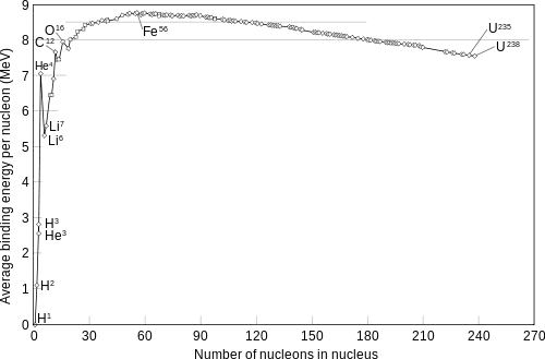

The answer lies in this diagram
It shows the binding energy per nucleon over the number of nucleons n in a nucleus. As you can see, it has a maximum around Iron (n=56), which means that left from iron energy can be released by fusion. For elements heavier than iron you need to put in energy to fuse them together, or equivalantly that fission is energetically favorable. That is why conditions like in a supernova are necessary to produce the heavier elements.
So, fusioning ${}^2H$ to ${}^4He$ releases energy, but the reverse fission process costs energy. There is no net gain, even in a perfect aparatus.
